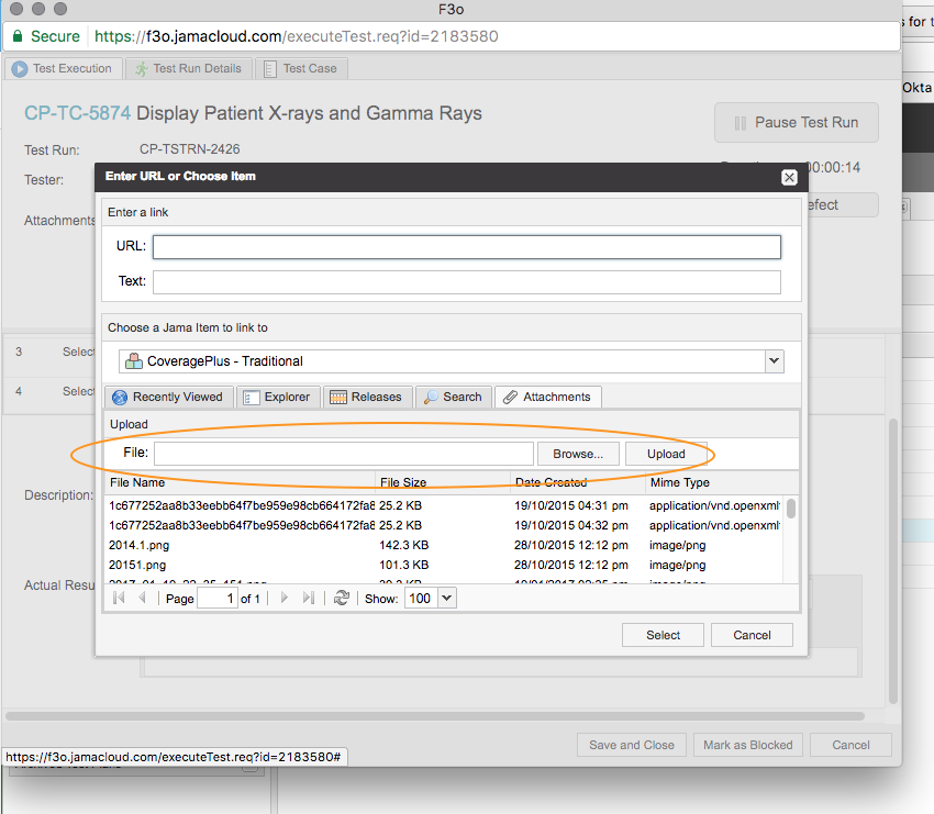

    At this point it is just not possible to enable attachments in Test Runs for those with a Collaborator license. Using the attachments widget requires a Creator license with project Edit permissions (because attachments are visible project-wide regardless of permissions), and this is by design. I checked in with our Product team to see if we might be considering a change to this, because your feedback is so true-many testers are required to do more than write info and embed screenshots.
    However, there is a workaround when you use the Rich Text Editor in the Actual Results field. If you select the Link button, you will be presented the following screen, where you can choose to link to a URL, an existing item in Jama Software, or an existing attachment in Jama Software-but you can also choose to attach a new item.
    This isn't perfect (because it is not obvious), but it should at least allow your testers to attach needed documents and move on with testing.
