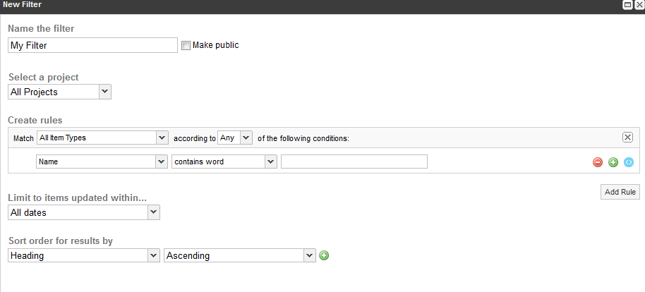

    Hello JAMA Community,
    I would like to export 'item need more work' filter result from Review Center.
    Or could I filter this items within JAMA Filter function? What would be the rule for this?

    Hi Sergej,
    It is not possible to export directly from the Review Center (and the only custom report we have for this is to export comments on items). There also is not a way to see the "needs more work" filter within the project filters, as the "needs more work" condition is unique to the review center; filters rely on the values in fields and location. What I recommend is updating process by adding a custom field to items to track their review progress. In that case the item can be batch updated in the review center if it's approved, and then you could go back to the project and filter for items that are not approved/require more work.
