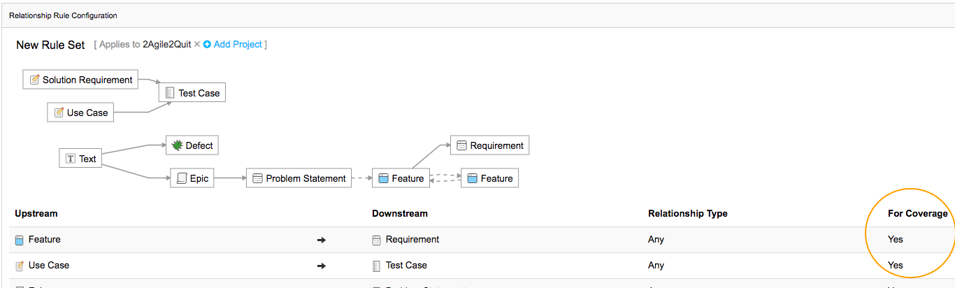

    The Add Coverage link is there if you have checked For Coverage in the Relationship Rules, so you may or may not want to change that setting. But if you change it to No, that link will disappear.
    Admin > Relationships > Add Coverage setting
