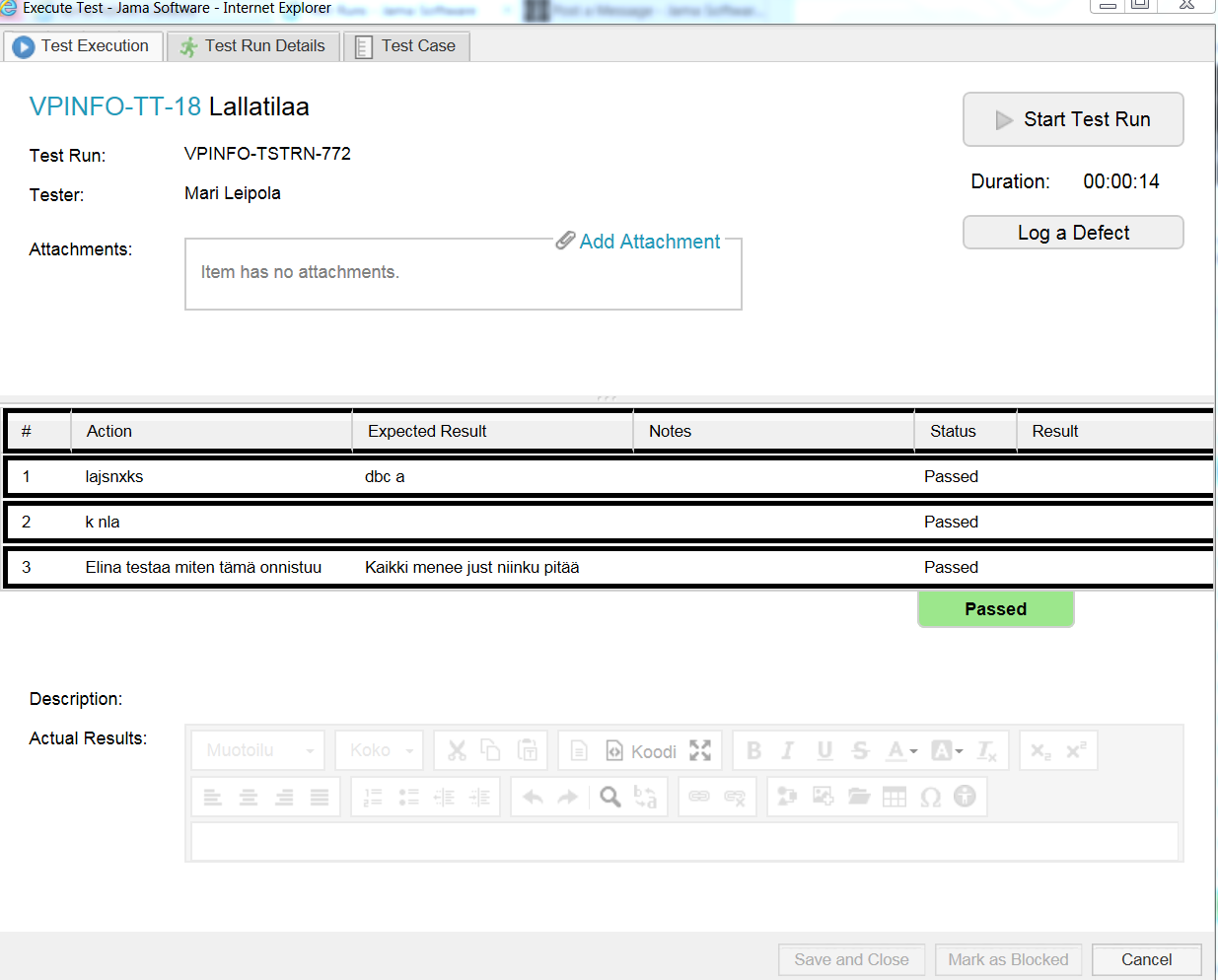

    ​Hello! I would like to ask about Test run attachments.
    There's a possibility to take for example print screens during testing and add them to Execute test -window (pls see below). But is there any possible way to see attachments or even to see that there are attachments in the window, other than go through every Execute test -window?
    Attachments don't show in test run view.
    Thank you for your patience with this new JAMA admin and have a nice day!

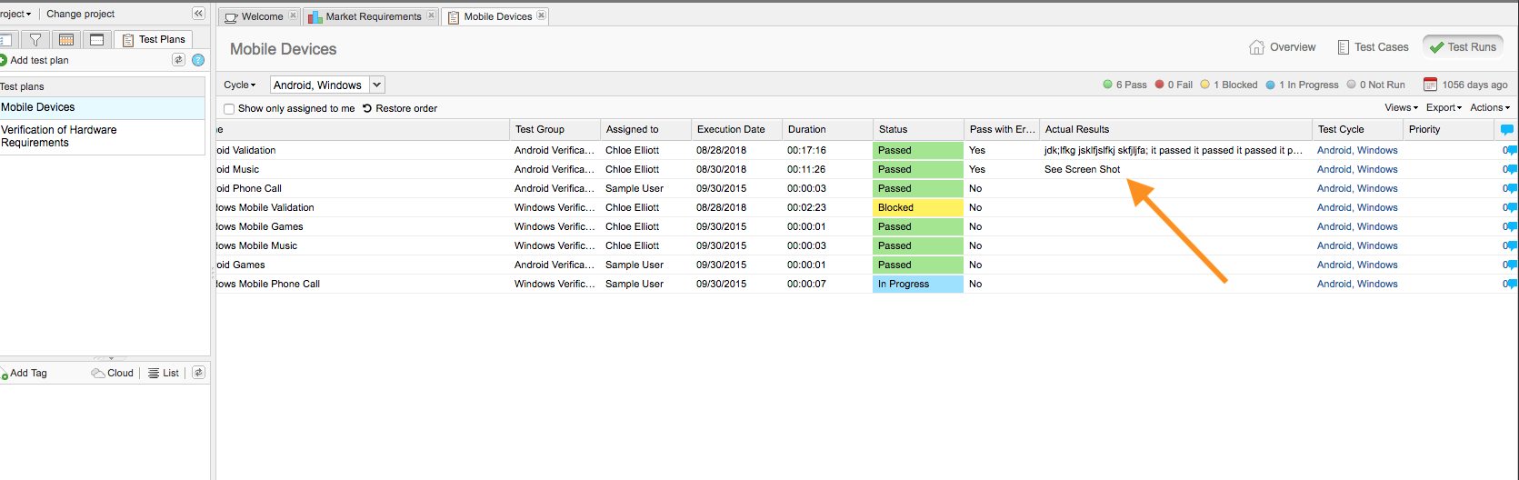

    Are you using the actual Attachments field above the steps or are you using the Actual Results field below the steps?
    The 'workaround' we have found is to note in the Actual Results field "see screenshot below" and then embed the image. Then if you go back to your Test Run screen, you can configure in your view to show the Actual Results field. You will see the "see screenshot below" verbiage, but not the actual image, but you have an indicator that there are some images at that point. You could also say "see attachment" in the Actual Results field as well, and then add the attachment to the Attachments field.

    I would do what Angela suggested and use the Rich Text Editor in the Actual Results field to embed your screenshots / create "screenshot" indicator, here is what that would look like during the test run (arrows pointing to the icon for embedding images and the text "See Screen Shot":
    And then this is how it would look when you go back to the Test Run Screen (arrow pointing to text "See Screen Shot" we can now see in this view):
