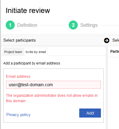

    I tried this feature on 8.64.0. It is possible now to enter a '-' and it works for the Stream, but not for the review center. When the entered domain has a '-' in it, the review center always reports "The organization administrator does not allow emails in this domain".

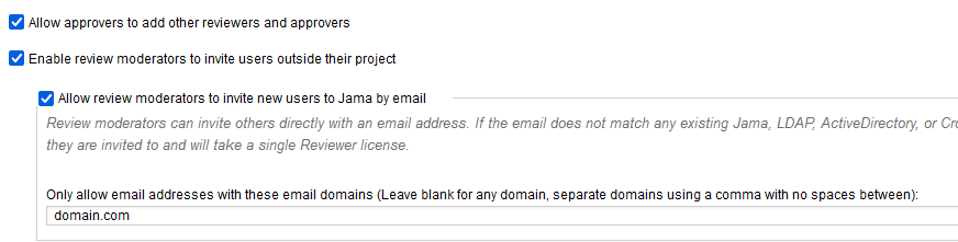

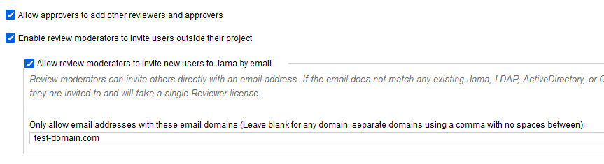

    Example settings as below:
    Result in the Review Center:

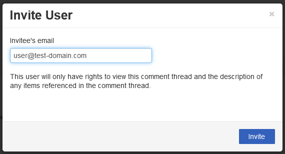

    The same domain works for the Stream:

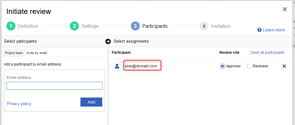

    When using a domain without '-', it works correctly:
