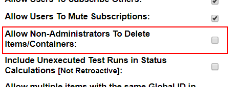

    You can turn on/off the ability to Delete for all users (except Admins) in the system:
    But this is too broad of a control -- either everyone gets to delete or nobody does!  (Note: they would also need the "Create/Edit" permission to be able to delete)
    We are seeking finer delete permission granularity, ideally, to be able to configure:
    • at the user level
    • at the group level
    • at the project level
    • at the component level
    • at the set level
    Edit:  That is, we would like to be able to grant users the ability to create Jama items, yet not necessarily the ability to delete items.  We would like to grant the delete permission to a small subset of users.
