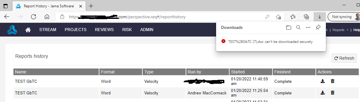

So, it seems that some browsers don't let you have http downloads from an https page, as a security measure. So I wondered why it was http. Turns out when IT set up the settings the "Base URL" was done with http, not https. We fixed that and regenerated the URLs and everything worked again!

Seems that it works OK in Firefox, and Edge gives this security error:
