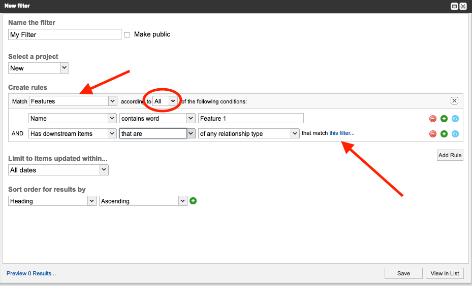

    If you want to target a particular Feature item and its downstream items I would start with this:
    Match: Features according to: ALL.
    Name contains word: "Put the name of the particular FEAT you are targeting"

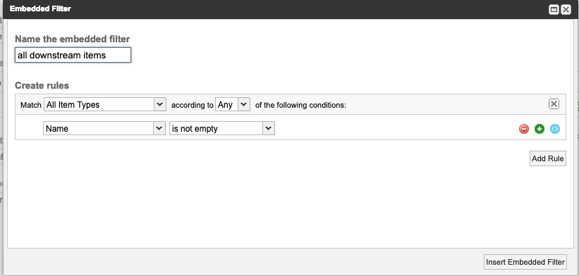

    AND: has downstream items that are of relationship type.....(click to insert embedded filter)
    In order to capture all the downstream items of this particular Feature item I would set this embedded filter to match All Item Types according to Any Name that is not empty. This will pull anything downstream item which has a Name in the Name field, which every item should have a name....

    You might also need to consider your relationship rules. Note that this embedded filter will only return the items that are directly related to a Feature. If your relationship rule defines a decomposition chain of relationships - Capabilities to Features to Stories to DS-FS to Test Cases - the embedded filter will stop at Stories. It won't return the DS-FS and Test Cases that are downstream from the Story(ies). Other tools can supply more than 2 levels of traceability.

    Thank you for your responses. Unfortunately the filter didn't work me. Our hierarchy doesn't allow linking of all items to FEATs, so I suspect Theresa's comment partially explains a limitation we face. More basically, although I set up a filter just like your example, Chloe, I couldn't get the filter to display more than just the specified feature. I wonder if that's because the filter is set up to match with Features only (as in, match all FEATs that have ID foo AND have downstream items that contain names). Thoughts?
