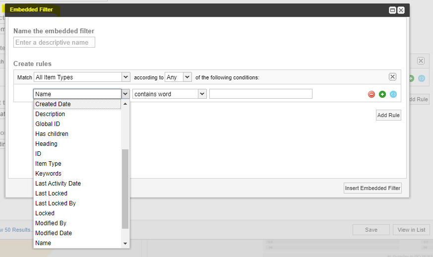

    Release and location fields will not appear in the embedded filters. It would be great if these are also provided. This makes users to filter better based on these fields as well.
    Suppose that we have two item types Use case and Test Case. User may related these two item types. The Use case does not have the release but the Test case has the release field. Then we cannot get all the use cases which are related to test cases in a release right?
    This is the issue we are facing now.
    But in general when we are selecting an item type in sub filter, and that item types has release related field, then the drop down in the sub filter should show the release right? But this is not the case in current JAMA 2014.1.
    It would be great if we get this feature.

    I've got a good workaround for you wrt the release field.  In the embedded filter choose "keyword" and then type release: <your release name>
    This will work with any normal field (unfortunately not with location...I agree this would be awesome).
    If the release name has spaces be sure to include quotes e.g. release: "Release 1.0"

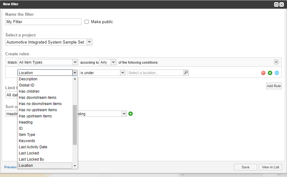

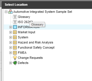

    the discussed request here is similar to the entries in the product ideas - https://community.jamasoftware.com/product-ideas-suggest/ideation-home/viewidea?IdeationKey=f05e078b-6a7c-41b4-ba7c-f1618edfb67f
    Release and Location criteria are currently only available at the first level of filtering.
    We would like to have the same criteria (location and release) for an Embedded Filter.
    When the user selects Location in  an embedded filter, Jama Connect should provide the Option to select any location  with "Select Location" just as if Location was selected at the first level filter like today. The Location criterion in an embedded filter should not be limited to a type of container.
