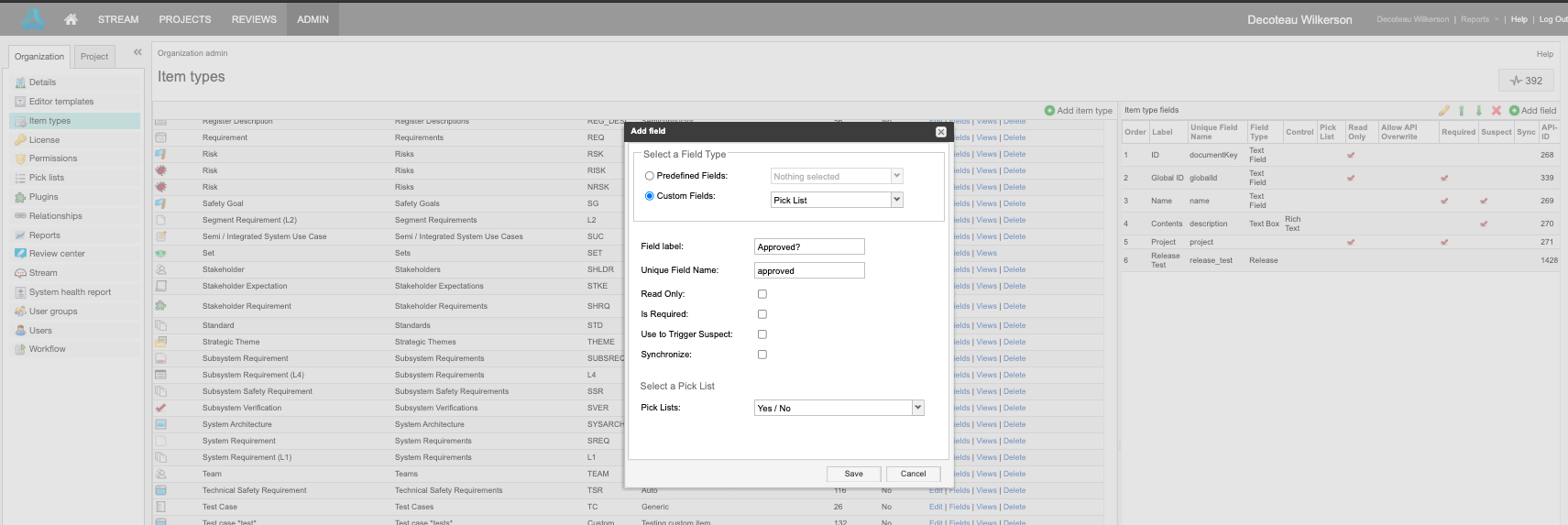

    In my test, I added a custom picklist field, named it "Approved?" (you can name it whatever works best for your use case) and associated it to a simple "Yes/No" picklist:

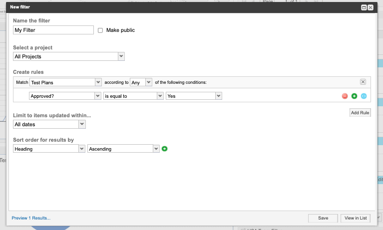

    and created an Advanced Filter to search for this response:

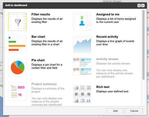

    Finally, I added this Advanced Filter as a widget on my Project Dashboard. Doing this will allow you to keep live results on your dashboard to return all "Yes" results as they are updated.
