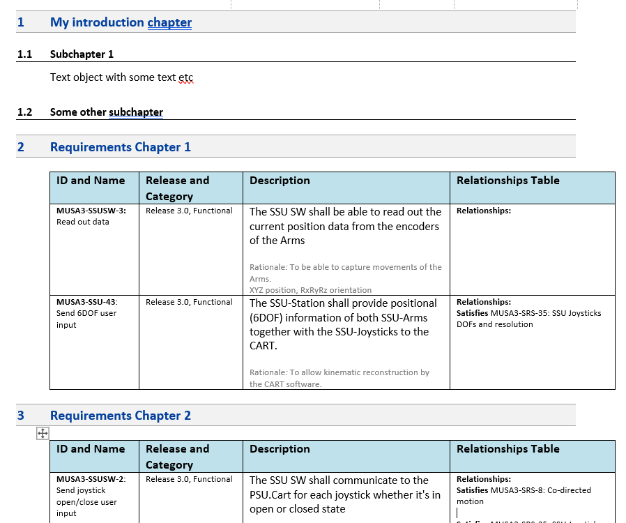

The problem is that I need:
- General introduction chapters (TXT in FLD), just showing folder name + description --> works
- Requirement chapters (SRS in FLD), exported into tables --> works
- Each table in Item type SRS should have a TableHeader --> does not work
I cannot get the TableHeaders to repeat as desired. I understand what happens/why I get the wrong result, but need help with the correct Template markup.
What I like to get exported (but cannot get):
One header PER table
I come close, but do not get it right entirely.
I can get either one of the below, but not with a TableHeader per table:

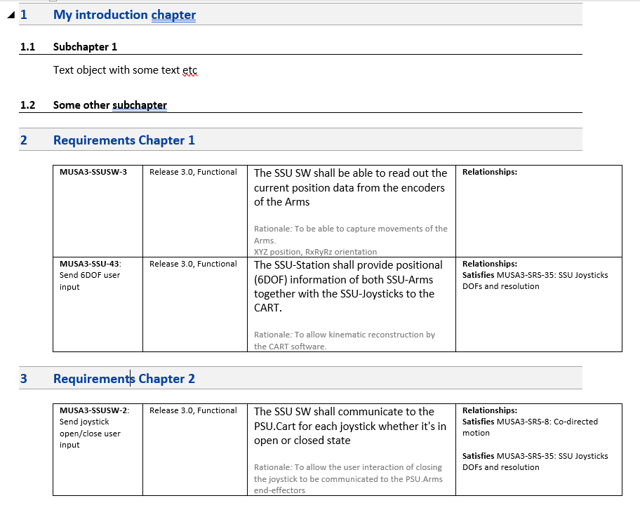

1. Not right: No tableheaders
Exported from JAMA:

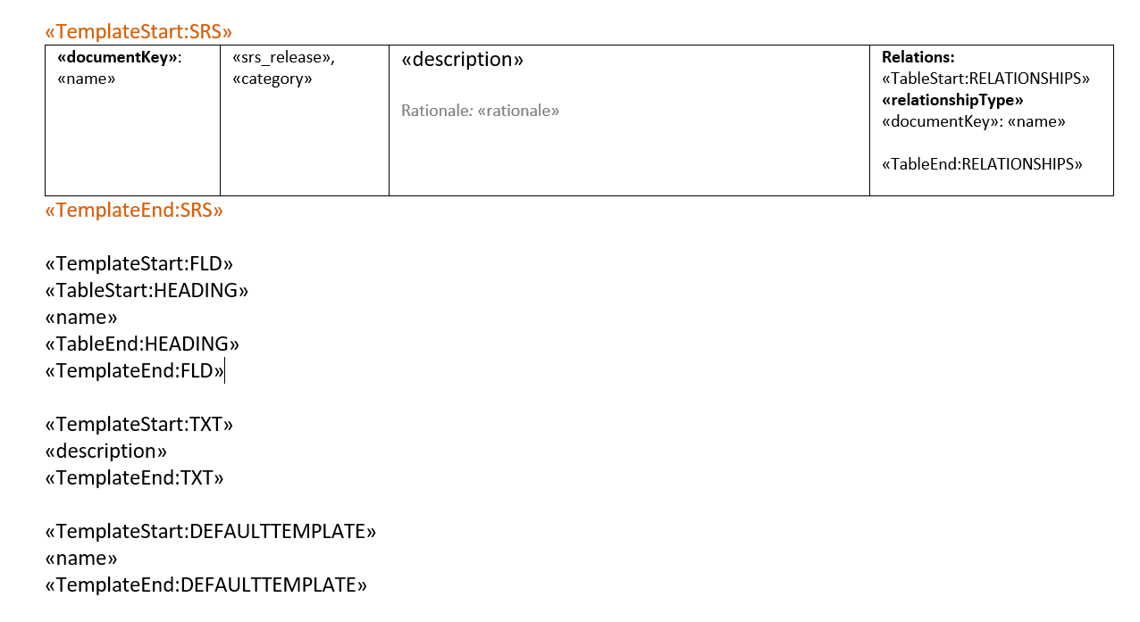

Uses template:

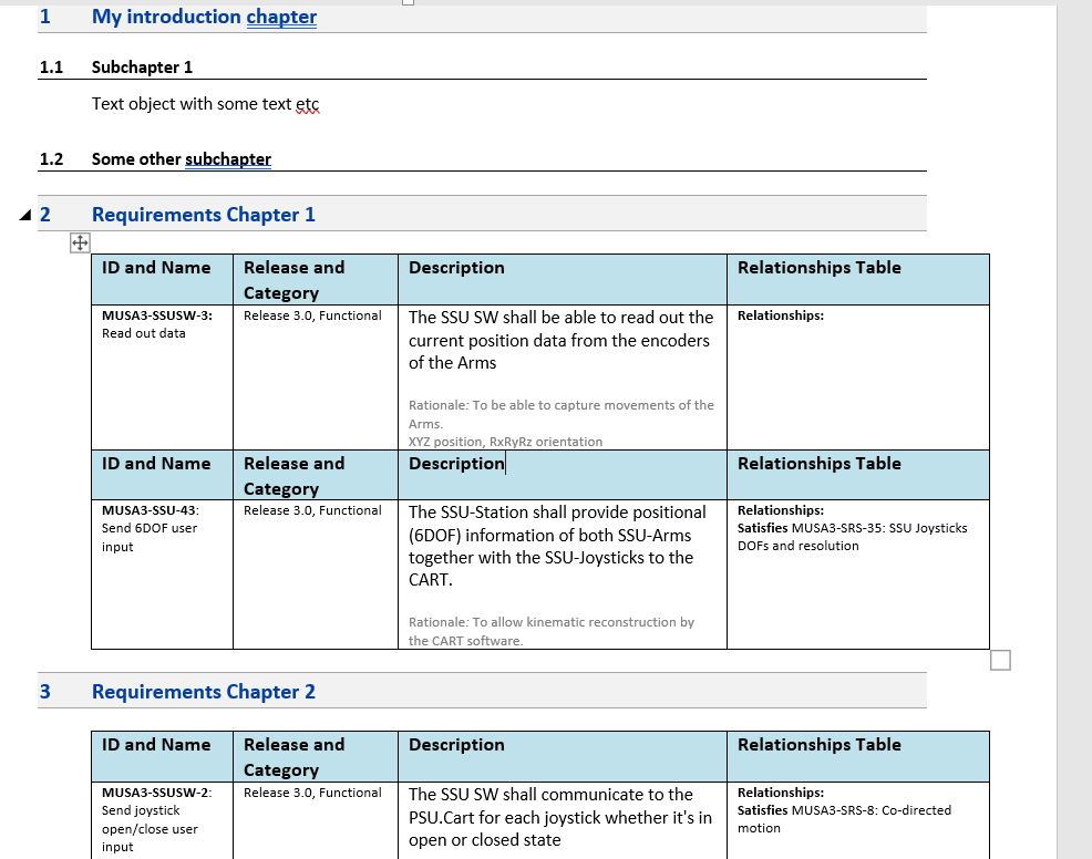

2. Not right: Too much tableheaders (per item)
Exported from JAMA:

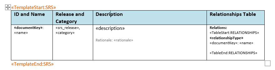

Uses template:
