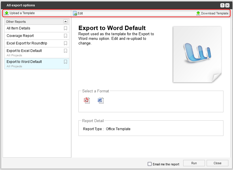

    are you on the Cloud or Self-Hosted version of Jama? On Cloud you usually have to request Jama Software Support for help. On Self-Hosted, an Admin can upload a customized template, which can be a simple Office Template, Velocity or a BIRT report.
    Office templates can also be uploaded from the "All export options" window, or you can download the simple office templates from there, modify and upload again.
    The "All Item Details" is a Velocity Report, which cannot be downloaded or modified (even in the Self-Hosted version). So you probably have to build it from scratch, or get in contact with Jama Support and ask them to provide the template and install it on your instance. But for modifying velocity reports, you would need to know how to write them.

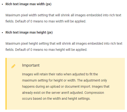

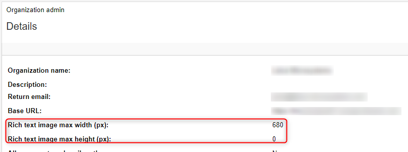

    I don't think that there is an easy way of resizing all images automatically in Jama. That's a manual change you have to do item by item.
    Nevertheless, in the Admin section, there is a setting for the max. pixel size of images in rich text fields. You can try to adjust it, but it won't affect images which were already uploaded.
