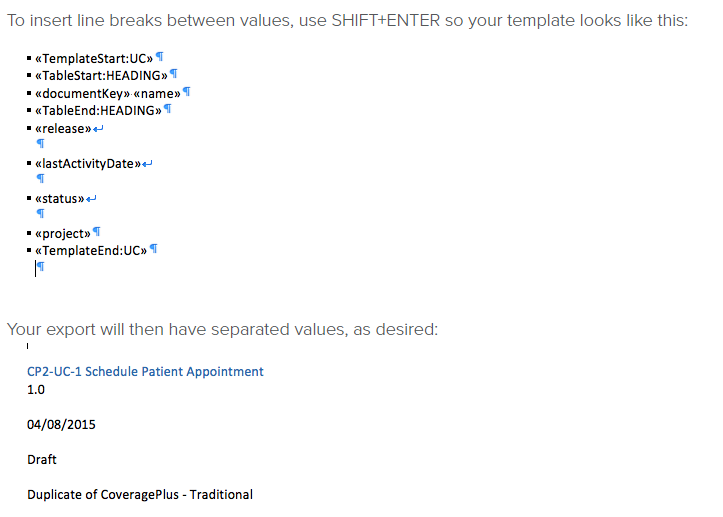

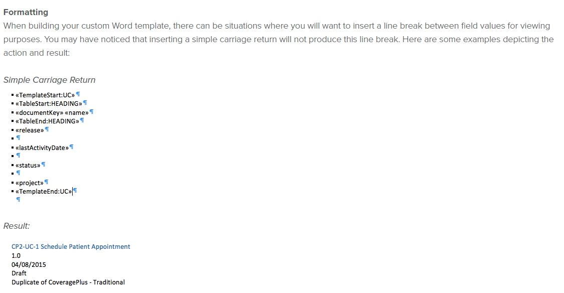

    Hi Mohamed,
    see here:
    from:
    Custom Word Template Easy Start Guide (jamasoftware.com)
    Is this what you were looking for?

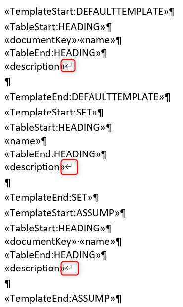

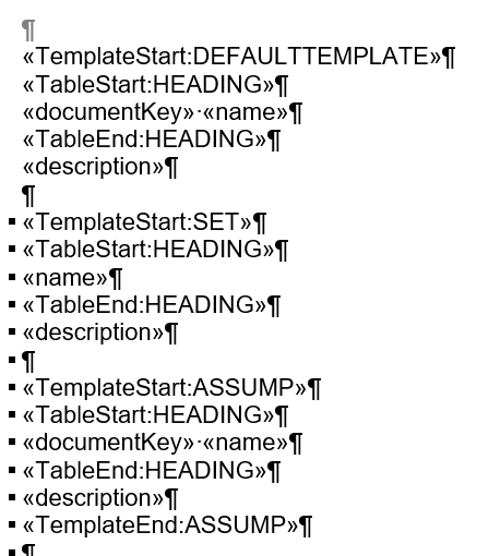

    So here I am adding space before template start but it is not working. Probably I am doing it wrong.
    Should I put the space instead before "TableStart" or "name"?

    First of all, your example is missing the TemplateEnd for DEFAULTTEMPLATE and SET.
    And as described above, you have to use Shift+Enter and not just Enter to get the line break. It should look something like this (I haven't tried it):
