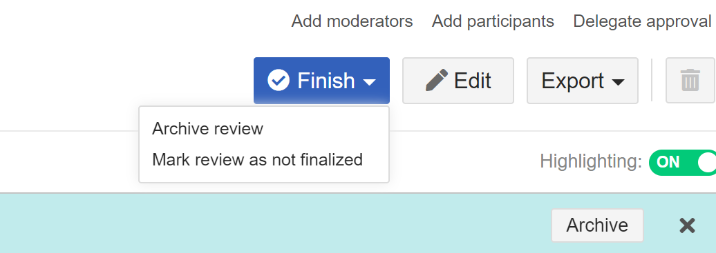

    Hello Carly,
    many thanks for coming back to me.
    Build date: 2021/11/19 15:44 Actually, I have figured out what is going on: my co-moderator had unintentionally clicked the "Mark the review as finalized". By clicking "Mark the review as not finalized" resolved things and the blue bar showed the expected behavior again. Issue solved.
    Perhaps not obvious to others either, why a finalized review can neither be updated nor recovered. May I suggest a little note to be added to the help:
    https://help.jamasoftware.com/ah/en/collaborate/reviews/moderator/publish-a-revision.html
    https://einride.jamacloud.com/help/ah/en/reviews-in-jama-connect/moderator-tasks/publish-a-revised-review.html
    All set. Many thanks,

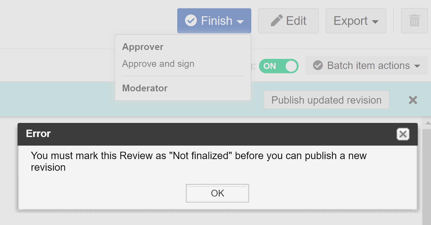

    Just let me add another screenshot which is kind of funny:
    Again, I had the issue that the "Publish updated revision" was not there. I cannot tell whether my co-moderator did something usual again, but this time, there was no option to "unfinalize" the review. The workaround was to not edit the Jama item in the source view, but rather to edit it from within the review center. Then, the "publish updated revision" button in the blue bar appeared. However, when I click on it, i get the following error message:
    Too bad that the moderator menu doesn't give me any option, not even to do the wanted unfinalize.

    ...and to recover from the stuck situation:
    1. edit the review to change the expiry date to the soonest possible
    2. wait until the review expires
    3. refresh the browser
    4. no you should get access to the "mark the review as not finalized" menu
    5. then things should work as normal
