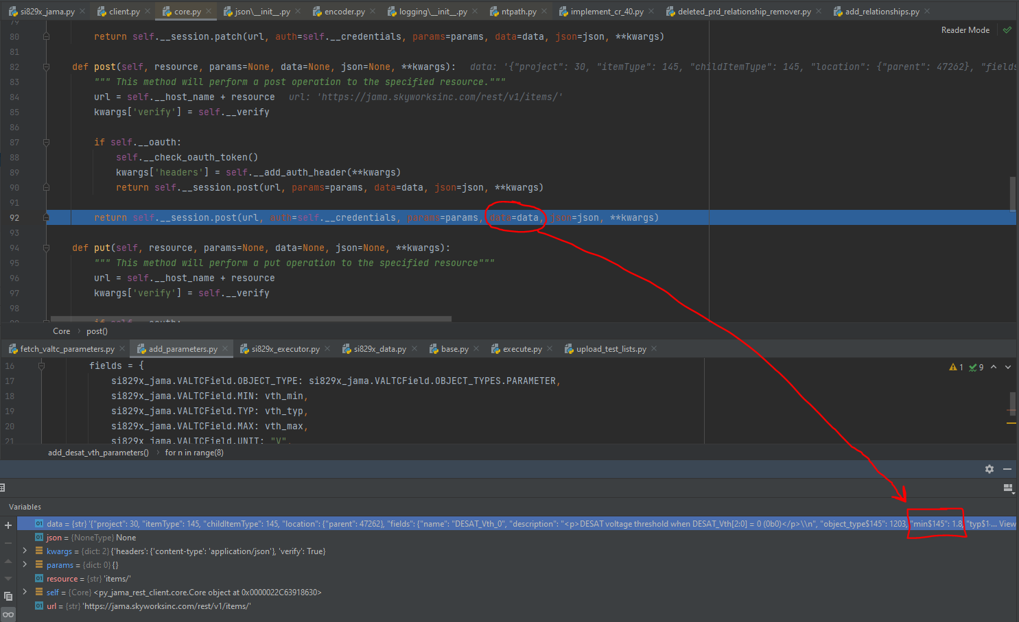

Using Python, I am attempting to add some validation test case (VALTC) items using the Python interface to the REST API.
I have done this successfully with other item/object types with no issues.
I am running into an issue when trying to POST an object which includes a Float field type.
Demo of the issue:
Debug view showing the "min$145" field value is a float (1.8) when passed into the POST method:
Error response from the API:
py_jama_rest_client.client.APIClientException: 400 Client Error. Bad Request. API response message: Could not parse min$145 with the value '1.8' from json. Please verify the value. Cause: Expected different type of valueSo my guess is that the API at some level converted the value from a float (1.8) to a str ('1.8') which is disallowed because the Min field type is Float:
So I am unable to create these parameters via the API.
