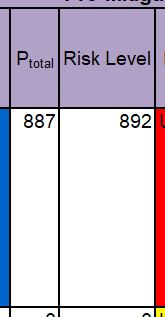

    Hi all,
    we use Jama also for Risk Analysis and just updated to 8.79.1 (self hosted) today. I setup the new lookup matrix feature to calculate P total and the Risk Level. In the previous version, we simply used pickup lists to select the P total and the Risk Level manually.
    When I now run our velocity report to export the risk analysis, I only get a number for the calculated lookup value, instead of the text. With just the picklist, the following code worked to get the text value and the associated color:

    Output example:
    What would I need to change to get the text and the color of the calculated lookup value?

    I found now a workaround which works fine, but it is just a workaround. Would be nice if there would be a direct possibility to get the correct values and colors.
    Here the code which works for us:

    <td class=xl88 width=90 rowspan=$riskRowSpan style='background:#$color;mso-pattern:#$color none;align:left;width:68pt'>$!riskLevelString</td>​
    Fortunately, the numbers (e.g. 892, 893,...) always correlate with the same text. Otherwise this would not work like that.
