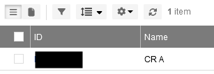

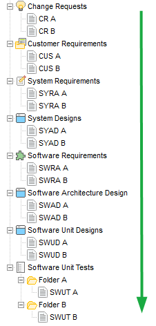

    See the following example where all "A"-items are linked togeter and also all "B"-items (CR A -> CUS A -> ... -> SWUD A -> SWUT A) over 8 layers total:
    Basically, I altered the search query to filter for:
    CR with location under <project root node> and which has downlink to CUS which has downlink to SYRA which ... has downlink to SWUD which has downlinkt to SWUT which is in Folder A.

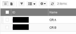

    This also works for releases in embedded filter. When changing the query to "... has downlink to SWUT which is in Folder A or is in release XYZ" and "CR B" being release "XYZ", both items are shown:

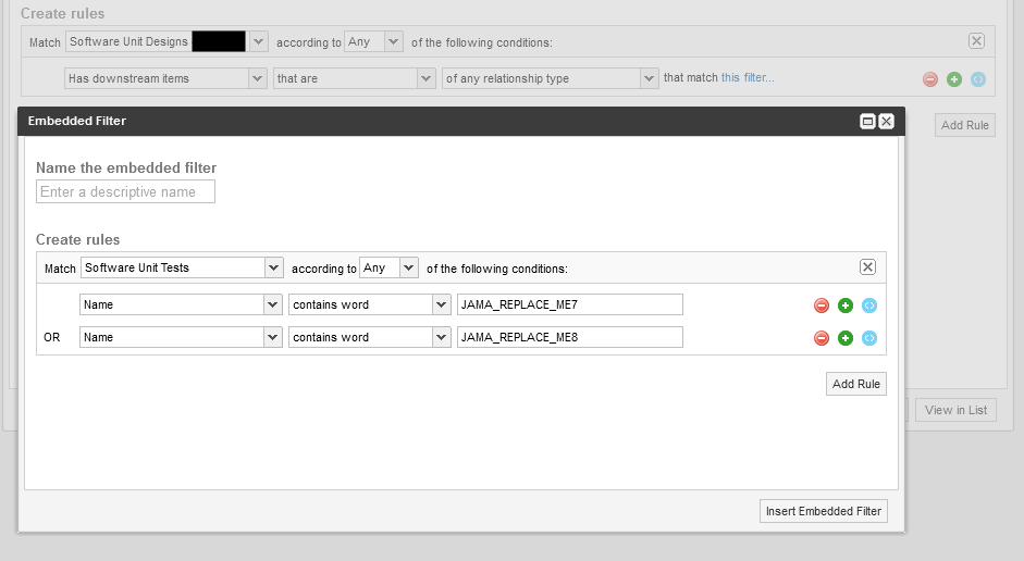

    Because I don't think doing this manually is a good idea, please see the following python script I wrote (See this site if you do not have python installed). You just have to fill in the BaseLink (top most filter search query = URL in your browser when you hit "View in List" on a new filter) and the list of replacments (replacing from top to bottom). For each embedded query you have to do the same process as for the base link (you can use the full URL). For location/release embedding: The API ID of an item can be found in the URL when clicking on an item:
    Your unique replacement text (e.g., JAMA_REPLACE_MEx) must be in a name field with "contains word"-logic:
    The script will output the link for your search query.

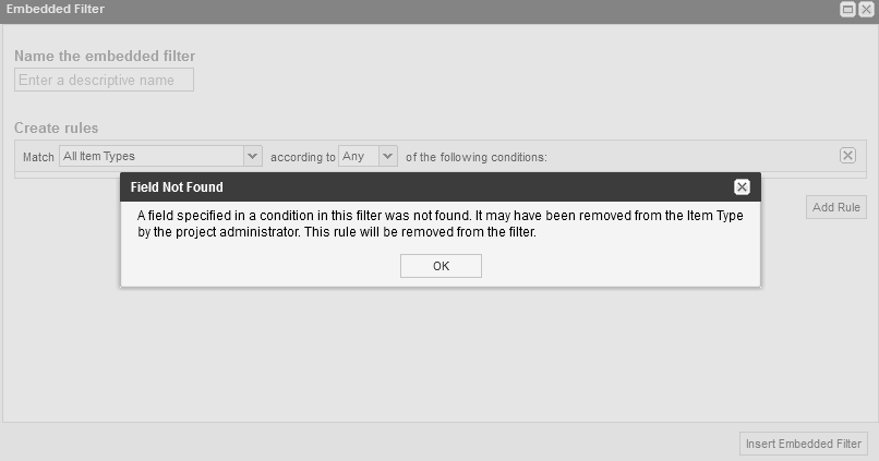

    • You can still edit the top level filter but if you try to edit the embedded filter you will receive the following prompt
    • The best part: You can actually save the filter with the altered embedded filters! It seems it's just the Jama GUI not being able to handle this process. Just open the filter link, click on "View to edit" and save the filter.
